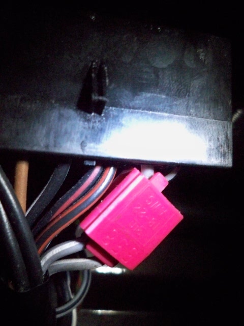

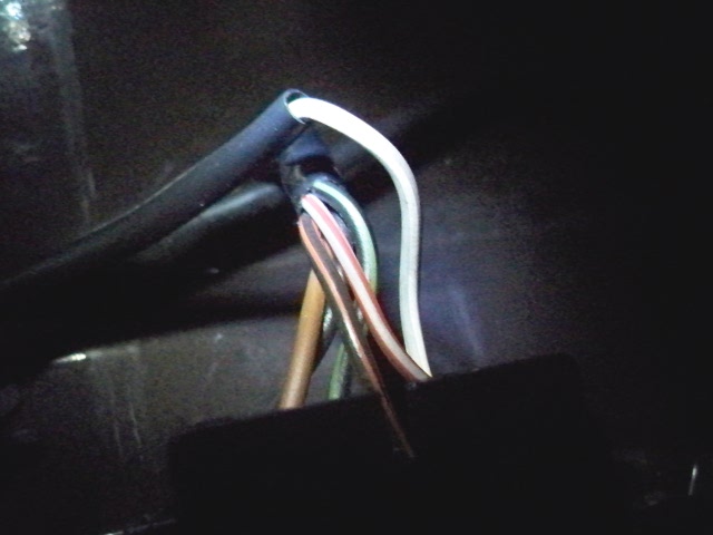

warum ziehst Du Dir nicht einfach ne Strippe vom einen NSL rüber zum anderen ?
In English: Why not run a separate wire from the one rear fog light to the other one?
That´s exactly how it is done on my Storm, see pics :grins: See the grey-white wire for fog light juice. First pic is the right hand side cluster connector, 2nd picture is from the left hand side cluster, where the wire for the right-hand side rear fog light is simply branched off with a Scotch-lock connector.

Tempest hat geschrieben:In English: Why not run a separate wire from the one rear fog light to the other one?
[ATTACH=CONFIG]48550[/ATTACH][ATTACH=CONFIG]48551[/ATTACH]
Tempest
Don't the L and R sides have different fuses? Not that you need your tail fogs to have two fuses....
Nope, as you can see from my wiring pics, both fogs run off the same grey-white wire.
